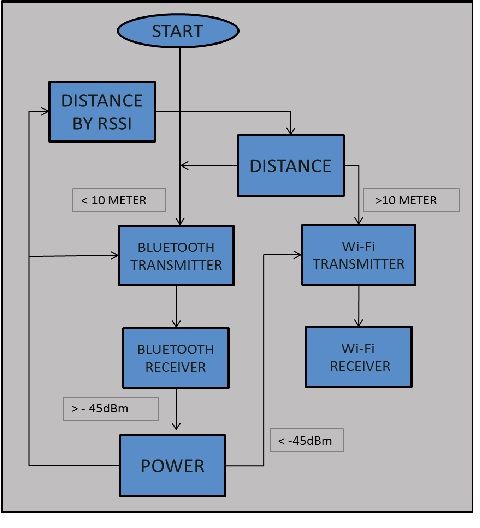

2018-04-02 7:20 AM
Does this above algo suits the RF switch.
Thanks
Phani
2018-04-02 7:51 AM
Depends what OP meant by 'XBEE'.
XBEE it is a whole product range from Digi - not a single product, and not a single radio protocol:
