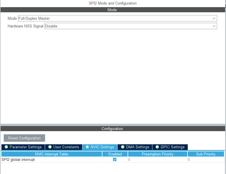

SPI_DMATransmitReceiveCplt is not called. Is there something we need to set? Do we need to set the ioc file?
2024-12-23 2:10 AM
Have you enabled the interrupt?
2024-12-23 2:19 AM
By interrupt, do you mean a DMA interrupt?
The DMA1 stream2 global interrupt (the DMA stream we are using) is enabled.
The target SPI global interrupt is disabled.
2024-12-23 5:17 AM
You should set CS high in HAL_SPI_TxRxCpltCallback.
If that's not working, show the relevant code. Ensure DMA interrupts are enabled.

Thank you for your reply. I was able to solve it thanks to you.
