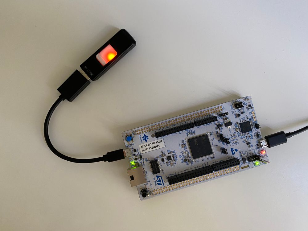

Setup:
Nucleo-H743ZI2 board
USB 2.0 OTG adapter
USB 2.0 flash drive, 3.72 GB, FAT32

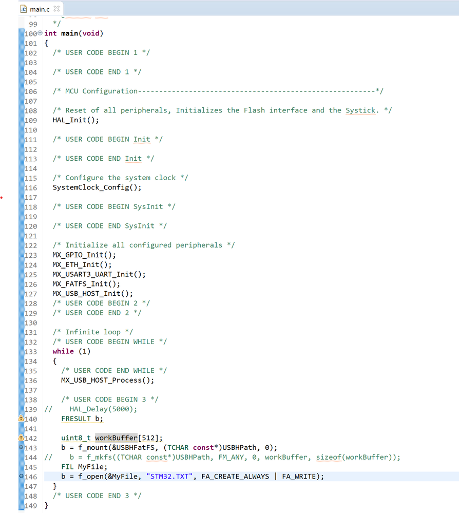

MX_FATFS_Init(),MX_USB_HOST_Init() and MX_USB_HOST_Process() are generated automatically.
After that f_mount(&USBHFatFS, (TCHAR const*)USBHPath, 0) return FR_OK
f_open(&MyFile, "STM32.TXT", FA_CREATE_ALWAYS | FA_WRITE) return FR_DISK_ERR
Since I get the same return value even without plugging in USB flash drive, I suspect it did not actually see my flash drive. My flash drive lights up, which means power is on.
Please let me know what I missed here. I have attached my complete code and a screenshot of main program as well.
