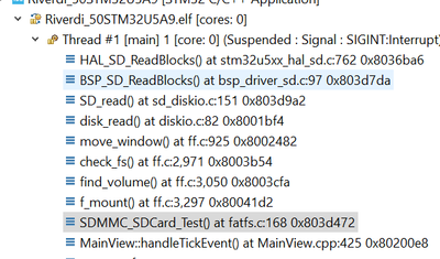

This is regarding the same issue that I am facing after sometime of longrun in my SD card rea/write application. Here is the issue explanation:
1. I have more than 3 tasks running to execute different implementation. Major tasks in my application are UART task (having 30ms cycle time - osPriorityHigh), TouchGfx task (to update the received UART data in the display - osPriorityRealtime) and an SD card task (periodically update the device status every 5 seconds - osPriorityRealtime1)
2. With the above tasks priorities the application runs seamlessly for 40+ minutes and after that, the SD card task halts in the same API as before HAL_SD_ReadBlocks()
The application doesnt write data or show the updated UART data in screen, since the SD card task takes over the priority, and never returns. What should I do in this case? Can you please shed some light on this?

I reduced the SD_TIMEOUT from SD_DATATIMEOUT(0xFFFFFFFF) to 30000 and tried to run the app. The application ran for about 50 minutes and I got the FR_DISK_ERR in the f_mount() API.

Yes the SD read/write works for about 40-45 minutes and after that application seems to wait for the flag in the Fatfs layers and I am unable to recover from it. I am using a Sandisk micro SD 8 GB volume. Do you have any suggestions?
