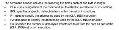

Need to know which type of protocol your SmartCard follows, T=0 or T=1.
The structure of T=0:
For T=1 protocol is more complex and it manages large data transfer.
So you need from you to understand how your Smart Card is operating. There is no other solution. Read again carefully the application note AN4800 and also AN4100.

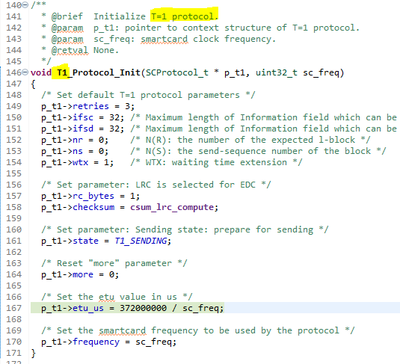

Ok, my card is T1 type because I run the example "\ SmartCardAN4800 \ AN4800_FW_V1.0.0" and it ends into HardFault_Handler because of zero division due to "sc_freq" value.

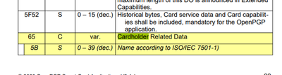

My card is GnuPG type and I have to read the CardHolder Name
that has 0x005B as tag and is under the 0x0065-tag directory.
So, what APDU sequence I have to send?
I'm newer in Smart Card and GnuPG.
Thankyou.
As I can see from the code sc_freq is an input to the function, so need to fill it with the smart card frequency in Hz.
