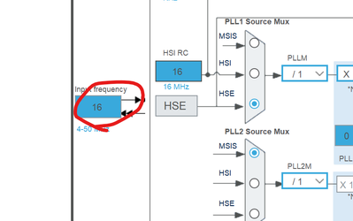

> Where do I set the HSE to 16Mhz.
In the clock configuration tab:

I've tried setting the input frequency to 16 as suggested, but that didn't help.
Any other solutions?

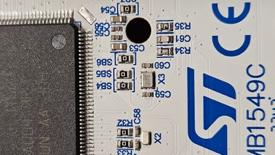

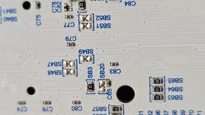

Here are some detail pictures of my board. I think these are the correct default settings. (I got the board from a customer. I don't think they changed anything to the jumpers.)

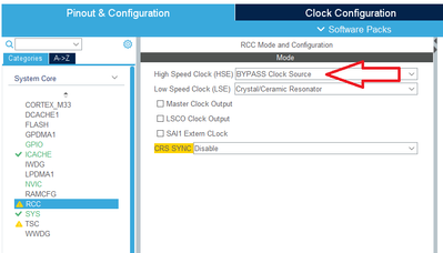

Never mind. Found the fix.
The setting for HSE must be set to 'Crystel/Ceramic Resonator', just like with the LSE.
Now I can debug my project.
