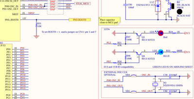

It takes too long, or the HSE is not present / connected.
Check board level jumper or solder-bridges (SB)
Clock typically derived from MCU providing ST-LINK, the frequency and presence of this can be changed/disabled
Check the HSE is populated, or wired to another source.

Is your clock set to HSE bypass? That is the default on nucleo boards, without modifying solder bridges.
Edit: it is the default on some boards, but, importantly, not this one.
2024-09-23 2:09 PM
Yes it is.
2024-09-23 2:35 PM
Some Nucleo boards have "HSE not used" as the default solder bridge configuration; for example, Nucleo L4XX.
2024-09-23 2:47 PM - edited 2024-09-23 2:50 PM
@Chris21 Thanks for the correction.
@lwatcdr It looks like on the NUCLEO-U5A5ZJ-Q, the 16 MHz crystal is hooked up by default, so HSE selection should be 16 MHz, non-bypass. Looks like CubeMX sets it to 8 MHz bypass by default for this board.
