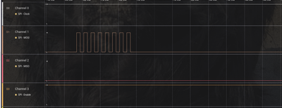

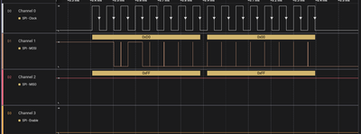

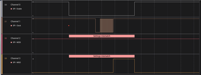

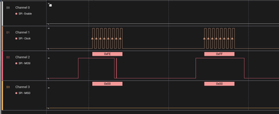

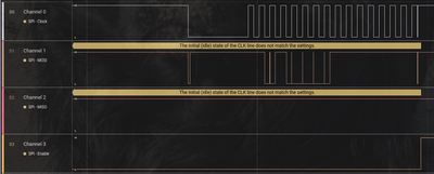

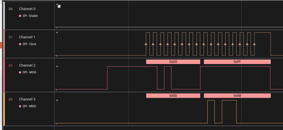

It's my first post and I'm trying to make something with the SPI but I met the problems. Even if I configure the interface (hopefully correctly), I can't communicate with any SPI device. I bought BMP280 as a simple sensor to communicate with. What I'm trying to do is to read DevID. It should be done by writing 0xD0 and then reading a byte (expected 0x58).
But it's not working at all. Using logic-level analyzer I have noticed something weird - bytes sent by SPI are delayed by about half a period of the signal. About, because it's not equal between the next attempts... I have set CPOL=CPHA=0 on both STM32H7 and the analyzer. If I change one side to CPOL=0 && CPHA=1 then I get the expected data (decoded) but only sometimes and only on the MOSI (0xD0 sent). The screens below show both situations.
CPOL=CPHA=0 Both
CPOL=0 CPOHA=1 One side
I have checked connections, I have checked the sensor (with the different MCU, not STM), and I have checked different pin configurations. I even tried to use AruinoSPI with PlatformioIDE. No matter what am I doing I'm getting similar results - random bits on the SPI...

2024-01-07 1:33 PM
It sounds like your MOSI pin is damaged, particularly the high-side protection diode. No fix for that but to get a new chip, or use a different pin.
Perhaps it was damaged by the same thing that damaged the logic analyzer channel, or perhaps the bad logic analyzer channel damaged it.
Double check that the MOSI pin frequency is set to very high, or set to the same as the SCK pin, but I doubt that's the problem.
2024-01-04 12:08 PM
Looks like a hardware issue, not a code issue. Looks like MOSI and MISO pins are shorted high, or something else is competing for their use.

2024-01-04 1:08 PM - edited 2024-01-04 1:09 PM
PC2 and PC3 are free on that board.
Disconnect the BMP280 and look the readings again. If MOSI looks correct, issue is in how BMP280 is hooked up. How is the BMP280 board hooked up exactly? What board is it?
Logic analyzer isn't the issue here--the SCK line looks perfect.

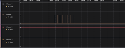

2024-01-05 5:22 AM
I have followed your advice but it's not the problem. Okay - this time I've got proper readings every time (0xD0 on MOSI) but ONLY if I set CPOL=0 && CPHA=1 on the one side.
I'm using module from Botland and here's the Datasheet.
The connection is:
STM32 | BMP
PC2_C -> SD0 (MISO)
PC3_C -> SDA(MOSI)
PD3 -> SCL
PB9 -> CSB
3V3 -> VCC
GND -> GND

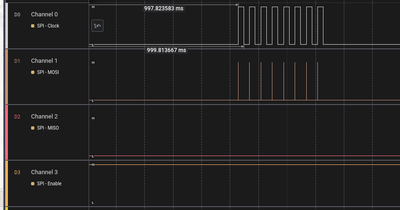

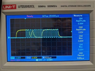

But as I mentioned - the behavior without the sensor is similar. Short peaks on the MOSI line are also confusing for me.

I've used SPI plenty of times, and this pattern on the MOSI is not normal. Was this monitored with the BMP disconnected? If not please, do that first to verify your MOSI output.
Then you can hook up the BMP again. If the BMP messes up the MOSI signal, it means that it's incorrectly connected.
Another thing that could help is to set CS high and low again after each transfer, if there's any clock mismatch between the 2 devices, that should recover it. Make sure it's long enough (so use HAL_Delay(1)).
Also, why are you not using the HAL SPI functions? For example HAL_SPI_TransmitReceive?

2024-01-05 6:01 AM
Those are not good signals. SCK is good, but MOSI and MISO should not be spikes.
Without the BMP280 connected, try initializing PC2_C and PC3_C as GPIO outputs and toggling them to verify the hardware can actually drive those pins correctly.
2024-01-05 7:01 AM

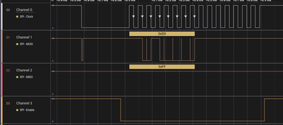

My previous answer in measured without BMP connected. Only the logic-level analyzer and board.
@Sebastiaan I decided to use registers instead of HAL because I had the same problems with it so I thought maybe something was wrong with SDK.
I have changed main() to HAL:

}But the result is similar (peaks and mismatches in CPOL/CPHA)

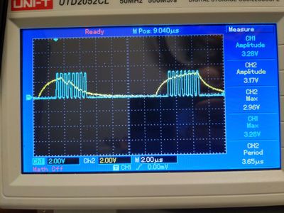

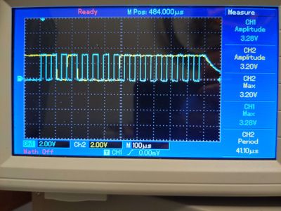

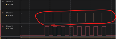

@TDK I have changed main to toggle the pins:
MX_GPIO_Init()
/*Configure GPIO pins : PC2 PC3 */
GPIO_InitStruct.Pin = GPIO_PIN_2|GPIO_PIN_3;
GPIO_InitStruct.Speed = GPIO_SPEED_FREQ_MEDIUM;
HAL_GPIO_Init(GPIOC, &GPIO_InitStruct);
}int main(void)
HAL_Init();
SystemClock_Config();
MX_GPIO_Init();
MX_USART3_UART_Init();
printf("Start\n");
HAL_Delay(1000);
for(int i = 0; i < 16; i++)
HAL_GPIO_TogglePin(GPIOC, GPIO_PIN_2);
HAL_Delay(1);
while(1){}

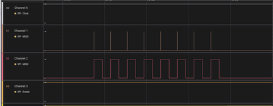

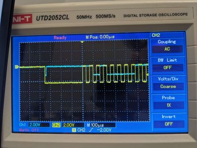

}And something happened... I've peaks on MOSI, switching MISO
But everything is okay while switching MOSI
So It's not short between lines. It happens even if I disconnect MISO from the analyzer while switching.
2024-01-05 7:16 AM
That's a good suggestion of @TDK, and shows there's a certain type of coupling.
You've never mentioned on what kind of platform you're working, that's becoming more important now. Is it a custom board, or an stm32 nucleo board? Or something else? Even if there's no short, there might be another component connected to the same ports? Can you look in the schematics?
Also, the glitches on the MOSI while doing the SPI transfer via HAL library are not the same anymore, they're only seen on the first byte now. Not sure what's the reason for that, maybe it's due to the CS that you're using now. You could also try to repeat the toggle test on the clock, and see if you see again the same glitches on MOSI.
But all of this is pointing towards some board issue, the code itself seems fine.
2024-01-05 9:08 AM
Sorry, but I forgot about it before. Switching SCK also results in MOSI peaks.
I'm using Nucleo-H743ZI2 (NUH743ZI$AT3). I looked at the schematics before I posted (schematics). Nothing is connected to PC2/3 or PD3. PD3 can be used with USART as a CTS but I'm not using Flow Control. To make sure I removed USART from my code but nothing changed (peaks are present as above).
Just for the test, I have switched to Hardware NSS but nothing changed.
