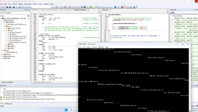

There is no test.txt file in my USB drive after the example is run.
The board sends this log
**** USB OTG HS Dual_Class Host ****
USB Host library started.
Starting Application
Connect your HID or MSC Device
USB Device Enumeration FailureTried to attach the USB drive to both USB connectors.
The last message is sent about 1.5s after the previous ones.
Where can be an issue?

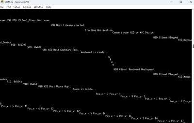

2025-08-28 4:10 AM
Hi @ERROR
I flashed you trusted binary as it is and it's working fine on my end!
Now, I'm suspecting your device or the USB adapter !

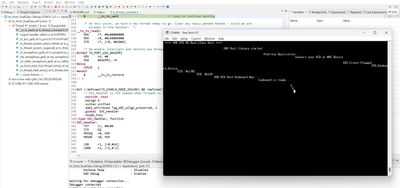

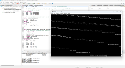

2025-08-28 12:36 AM
Hi @FBL
Thank you for your firmware!
Looks like you use a dev mode. I tried to run your ELF in STM32CubeIDE - the enumeration failure is again (i used "software system reset").
Usually, I use a regular mode loading the binary to the flash memory.
I took your ELF and converted it to the binary with the line below
arm-none-eabi-objcopy -O binary Ux_Host_DualClass.elf Ux_Host_DualClass.binThen I signed the binary and loaded it with the STM32CubeProgrammer to the flash memory at 0x70000000 (I use the external loader of course). The corresponding BAT file and converted files are included in the archive attached.
After that I set BOOT1 switch to the "L" position and reset the board. And I have the same "USB Device Enumeration Failure".
