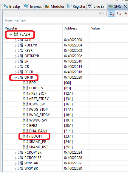

And about the ' FLASH_OPTR' register, in the STM32CubeIDE, for the MCU that I'm working with (STM32L4A6AGIX), there is no an field called nBOOT0 & nSWBOOT0, as shown in the attached picture.
So how can I configure BOOT0 now, that in a programmatically way, the MCU will load the burned program, from flash to adress 0x00000000, and will run the program after turning it on.

The option bytes are in addresses 0x1FFF7800-1FFF7820 (bank1)
On your picture are shown the flash control registers. They reflect the state of the option bytes in runtime.

Well, then I will kindly inform you that the SVD files (register descriptions) are just absolutely full of junk. It's not some bugs - basically every other peripheral/register has something wrong for every MCU. Look at the reference manual and you will see those bits.
@Pavel A., I'm not writing a separate program. I'm just checking the FLASH_OPTR register at boot in a normal firmware. Of course, the reconfiguration is done only if the bits are not at the necessary state. Such a solution has two advantages. First, one can flash the firmware to a new board/MCU and it configures itself at the first boot. Second, if some hacker manages to modify those bits, the firmware reconfigures them back to the desired state again at the next boot. That includes the RDP...
@KDJEM.1, just another register with wrong bits in SVD files like in hundreds of other registers in all SVD files...

Hi @Piranha ,
Thank you for bringing this issue to our attention.
I confirm that the FLASH_OPTR register is wrongly described in the SVD file.
I reported this issue internally.
Internal ticket number: 133087 (This is an internal tracking number and is not accessible or usable by customers).
