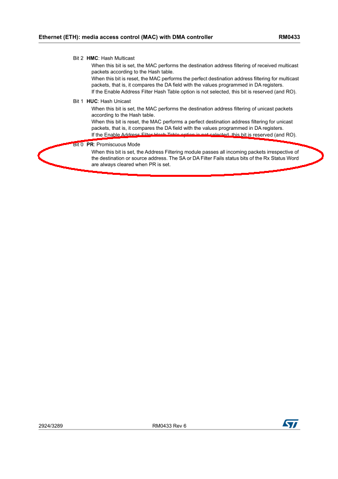

2021-07-14 5:33 AM
2021-07-14 5:57 AM
Once that bit is set how do I capture the packets via LWIP?
