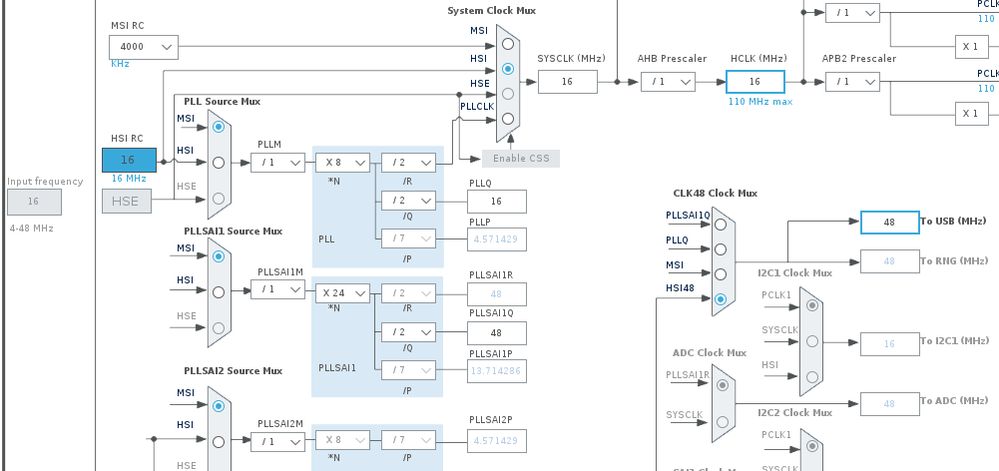

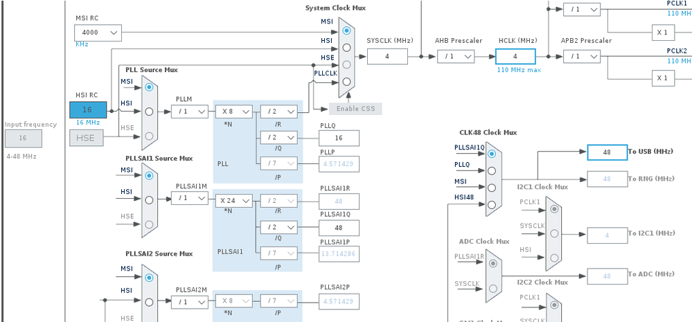

The solution suggested by GS@S didn't solve the problem for me.
Instead i still observed the same behavior as reported by GWett.1
It turns out the issue, in my case, was a faulty clock configuration generated by the Clock Issue Resolver of CubeMX.
This only concerns boards without an external high speed clock source (including STM32L562E-DK).
On a custom board with an external 16MHz oscillator USB, including the CubeMX Middleware examples, worked just fine.
On boards without HSE this is the clock configuration generated by the automatic resolver:
The problem in this case is that system clock and USB clock (via PLLSAI1Q) are both driven from MSI which (according to the datasheets) is not accurate enough to drive the USB controller.
After manually changing the configuration to this one everything works just fine:
Here the system clock is driven by HSI and USB is driven by HSI48 which the datasheet explicitly mentions as the only valid clock source for USB apart from an external high speed clock source.
