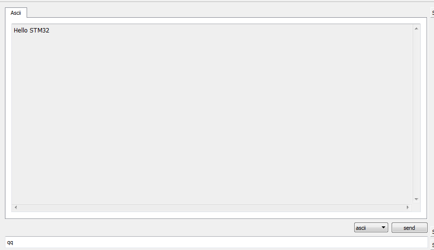

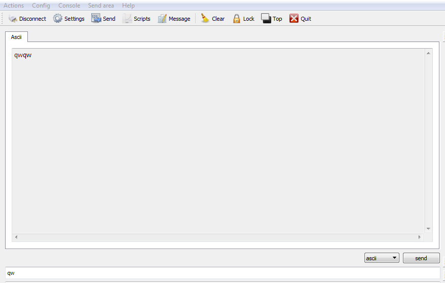

I am trying to send data to the console using the "echo" method.
static int8_t CDC_Receive_FS(uint8_t* Buf, uint32_t *Len)
CDC_Transmit_FS(Buf,*Len);
USBD_CDC_SetRxBuffer(&hUsbDeviceFS, &Buf[0]);
USBD_CDC_ReceivePacket(&hUsbDeviceFS);
return (USBD_OK);
I pass a random value but I see a doubled value in the terminal.
How can I fix it?

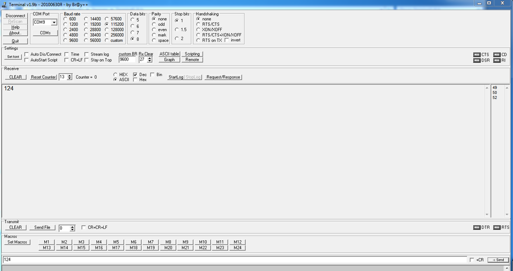

2020-08-21 4:00 PM
Another terminal program works correctly.
Apparently the problem is in the program settings, but in which ones?
I kind of tried all the settings.
2020-08-22 8:08 AM
If I transfer to the port in this way
uint8_t str[11] = "Hello STM32";
void StartDefaultTask(void *argument)
MX_USB_DEVICE_Init();
for(;;)
CDC_Transmit_FS(str,11);
osDelay(5000);
it's ok.
I don’t understand anything. Where to look for a problem in the terminal program or in the microcontroller code?
2020-08-22 2:40 PM
Double text is shown because the particular terminal has "local echo" turned on. Typically it should be turned off and only received text should be displayed. Tera Term and Putty are the industry standard and probably the best terminals.

2020-08-22 3:59 PM
"Local echo" means that the application just printed out the text you sent from the application. And after that it also printed the text it received from the remote device, which in this case is just a mirror.
