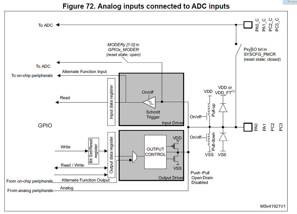

ETH_MII_TX_CLK signal is connected to PC3 and through the analog switch, it is connected to PC3_C. The analog switch can be closed by setting 0 to PC3SO in SYSCFG_PMCR register. The problem is in this analog switch itself because it doesn't have enough throughput for 25MHz signal clock and TX state machine lost the clock and stops working. It works only witch signal amplitude increased to 4V on PC3_C pin. With 3.3V it doesn't work because of high attenuation of an analog switch with 25Mhz signal.
RX clock is working because it can be connected directly to PA1 without an analog switch. PC3 pad is available only on TFBGA240+25 package.

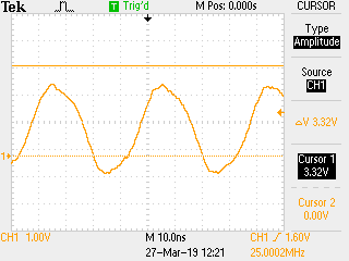

Working with increased voltage to 4V peek-peek

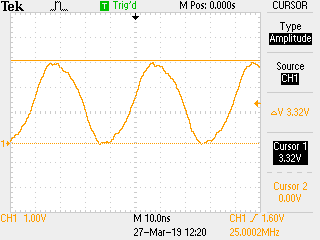

Not working with 3V peek-peek

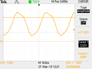

Not working with voltage +shift
Not working with voltage -shift
