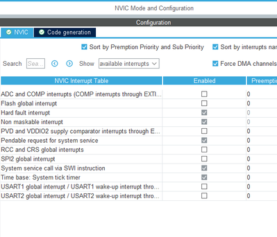

--- as you set it in Cube -> nvic settings (priority, active or not ---check this. )
Just make the priority ranking with some sense - and the Azure sys timer is handeled by itself, you cannot change its settings. (TIM6 or whatever you give it...)
