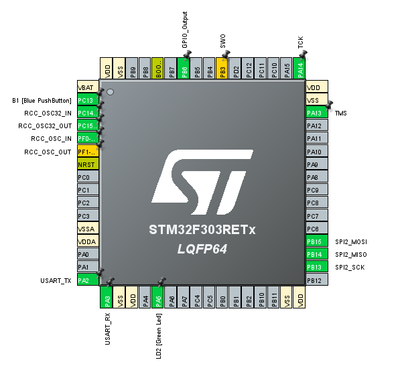

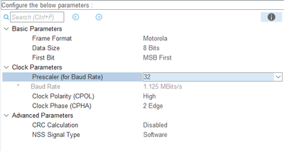

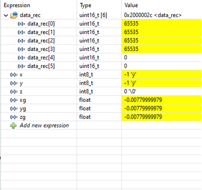

Hi, I’m having trouble reading measurements from the ADXL345 using SPI. I’ve attached a picture from the debugger that shows a view of the variables. The SPI is configured as master full duplex, and I’ve included a screenshot showing the SPI configuration. The SCK is connected to SCL, MISO to SDO, MOSI to SDA, and CS is connected to a configured output. I’m looking for help because I can’t figure out how to solve this issue.

Are you sure CPOL and CPHA are correct?

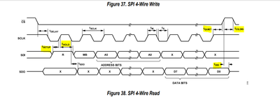

As you can see in the attached debugger screenshot, the reading from the accelerometer — specifically, the X, Y, and Z position measurement from the data_rec buffer array — is incorrect. I don’t have an oscilloscope. I’ve shared images from the ADXL345 datasheet PDF; if you could kindly check whether it’s configured correctly, I’d appreciate it. I have attached the schematic of my microcontroller in a PDF, along with a screenshot. The connections are as follows: D13 to SCL, D12 to SDO, D11 to SDA, and D10 to CS.

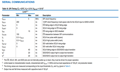

Hello @FilipF303RE
Did you check if the SPI timing fits the characteristics specified in Table 10 of the slave datasheet?

I tried to read the ID using TransmitReceive, but it didn’t work; after the transmission, it shows the address 0x00. Does this mean that I have incorrectly configured the SPI registers? It's strange because I configured them as described in the text documentation. So, the only possible troubleshooting method is using an oscilloscope?
