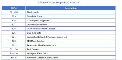

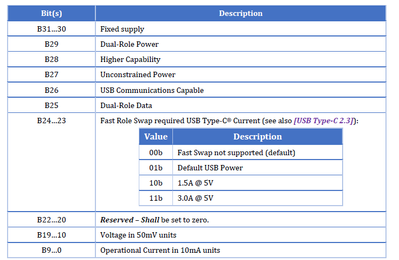

2024-06-05 3:38 AM
Hi @Marosh
SRC and SNK PDO are not built on same structure, so you cannot copy Received PDO from the SRC, into the SNK PDO of your equipement. Please check chapters 6.4.1.2 and 6.4.1.3 of Universal Serial Bus
Power Delivery Specification.
Example for Fixed PDO :
SRC structure :
SNK structure :
Regards
