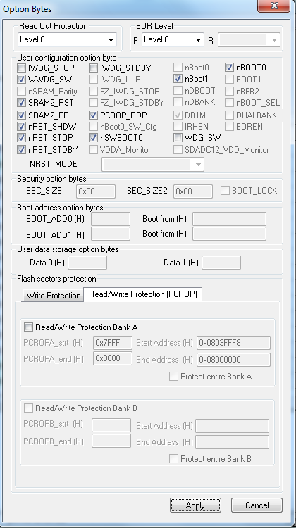

options:

2020-11-19 9:44 AM
2020-11-19 10:41 AM
