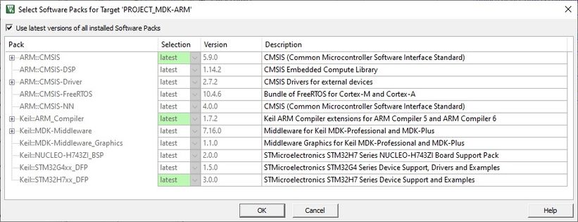

Hi STea,
here are the versions of the different software components used in the project
