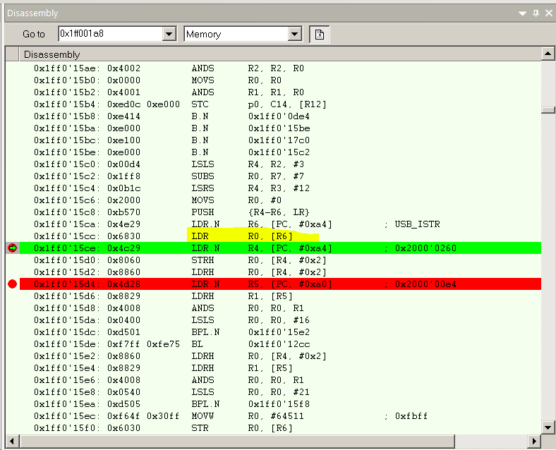

I have pinpointed where in the bootloader it goes wrong. The bootloader reads the USB_ISTR.
The value is 0x2000 on the faulty board and 0x0900 on the board that works.
It is the SUSP bit that is cleared on the faulty board. And I guess this makes the bootlaoder boot into DFU as it think there is something connected to the USB.

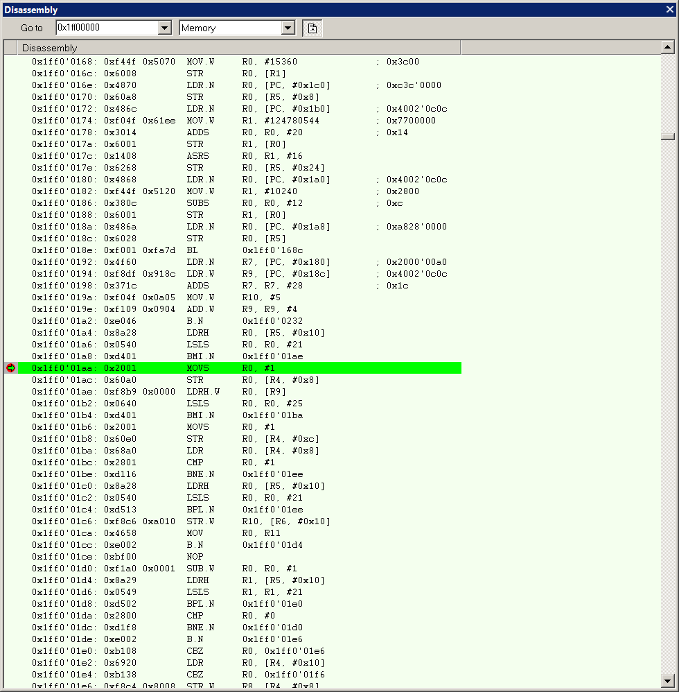

I tried on a working board and put a breakpoint at 0x1ff001aa where the bootloader has seen a zero on PA10. The run halts on this breakpoint when I send 0x7F to the MCU. All ok. But on a non working board I can't get it to halt at that breakpoint. I suspect that the boot loader has taken another path.

You could pause the "non-working" chip to see where it's at. The bootloader is going to go to the first supported peripheral it sees.
