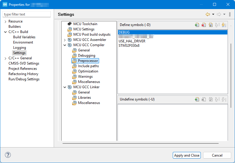

Yes HAL is same , but no only ld require change. If you use Cube IDE check and change build defines etc.
Can you please tell me where the build defines will be in which files. I have generated the code using MCSDK 6.4.0 and then manually edited the files
For pin mapping i have changed in main.h
stm32g4xx_hal_msp.c i have changed,
Application files i have changed.

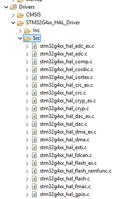

I copied all the HAL drivers in the folder Drivers\STM32G4xx_HAL_Driver\Src from the reference folder, the interrupt does not happen now. Can you explain me please i am really not able to understand i tried to optimize by removing some of the src files in the HAL folder, then this issue happened, if the src files are required why i did not get compilation error. It is really confusing.
There are huge number of .c files in the folder
more than this, i did not require them, what is the issue is it the root cause?
Hello @STuser2
Could you specify which files you removed?
Saket_Om
In the Project Properties:
