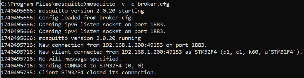

Mosquitto started with command :
mosquitto -v -c broker.cfgbroker.cfg file content :
listener 1883
allow_anonymous trueWindows IP : 192.168.1.105
STM32 IP : 192.168.1.200
Both IP are static. The ETH link is ok, I can ping the STM32. I'm blocked since a few day on the connection to the MQTT broker.

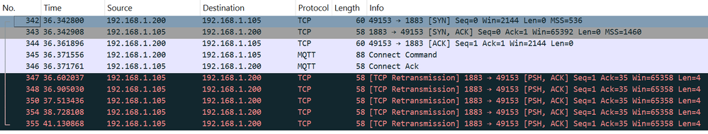

ConnectNetwork() works, but MQTTConnect() don't.
The STM32 send the request, mosquitto receive it and CONNACK but the STM32 don't received it and abort the connection.
I think I have localized the issue, but I can't resolve it with my limited knowledge in network programming.
