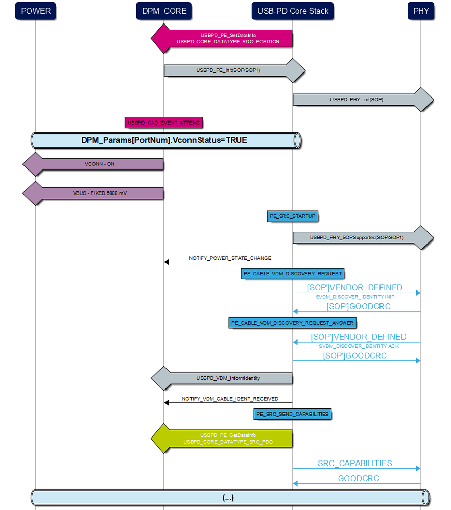

To get only 1 thread regarding your question, I'd prefer answering to the following question raised in another thread:
"I set the sop and sop_1 support in the usbpd_dpm_conf.h but when PE stack calls the USBPD_PHY_Init it just sets the SupportedSOP to sop."
"PE_SupportedSOP" defined is used to enable, if necessary, communication on SOP'.
Please find the stack behavior related to EMC cable detection:
1) Stack will communicate with cable only if a cable is detected. It means that by default, PHY will not acknowledge message from SOP' (what it is done by USBPD_PHY_Init function).
2) if cable is detected (USBPD_CAD_EVENT_ATTEMC event in USBPD_DPM_CADCallback function), the flag 'VconnStatus' is set to TRUE.
3) When stack is started, a check is done on this flag and automatic reconfiguration of PHY is done to be able to receive message from SOP' (through USBPD_PHY_SOPSupported function).
I hope it will clarify some points.

Dear @John886​
Rgds,
Yohann

Hi Yohann
Thanks for your explanation.
I got how PE stack works when e-marked cable attached..
