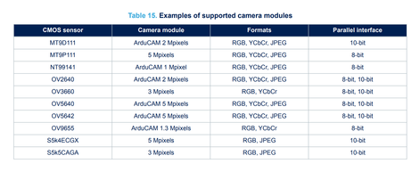

It is mentioned in AN5020 "Introduction to digital camera interface (DCMI) for STM32 MCUs" that OV5642 as an ArduCAM 5 Megapixels camera module compatible with STM32 DCMI.
For the connection between the camera module and STM32F7508-DK, I advise you to refer to the camera module datasheet and to board schematic. Note that this board has an "External Camera connector".
