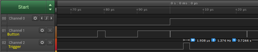

When I try to send signal TRIGGER for the first time I get strange early interruption. On the picture, you can see measurement performed by logical analyzer after pressing the button (which also sets high level on TRIGGER and starts timer):0690X000006CjEuQAK.png

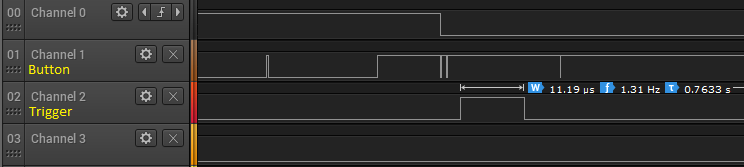

Next press:0690X000006CjF9QAK.png
I can ignore this first interruption since after it timer works correctly. But to make library work I use two timers instead of one. For now it is not so bad but it is improper approach and I would like to understand why this happens.

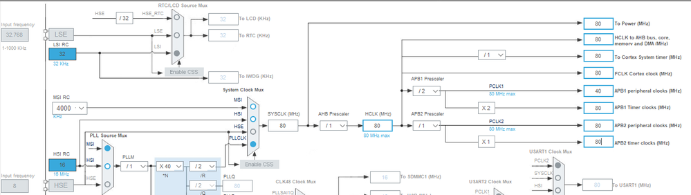

 Clock configuration
