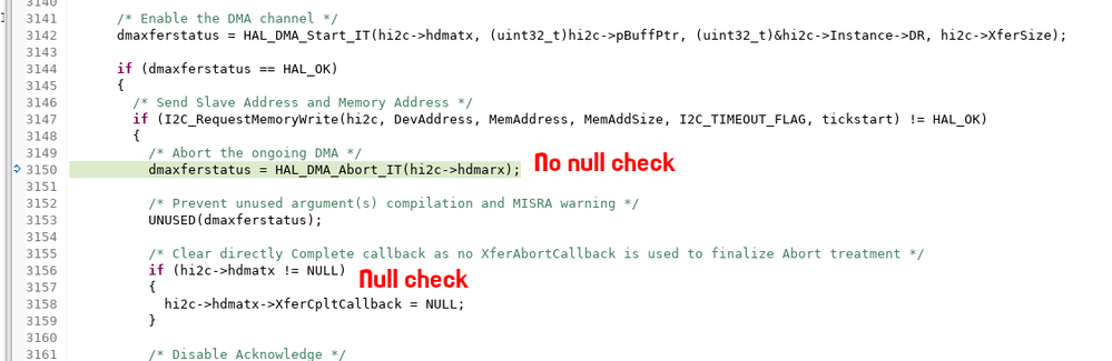

(STM32Cube_FW_F1_V1.8.2/Drivers/STM32F1xx_HAL_Driver/Src/stm32f1xx_hal_i2c.c)
In HAL_I2C_Mem_Write_DMA, hi2c->hdmarx may be null but this is not being checked. This causes a crash when invoking HAL_DMA_Abort_IT if there is no DMA used for receiving.
btw is there a better place to report this?

Hi @iforce2d ,
You're right, after more check and investigate, I confirm that there's a typo here:
/* Abort the ongoing DMA */
dmaxferstatus = HAL_DMA_Abort_IT(hi2c->hdmarx);
It should be hdmatx as some code after we check hdmatx value.
This issue will be fixed in the impacted families: STM32F1, STM32F2, STM32F4 and STM32L1.
