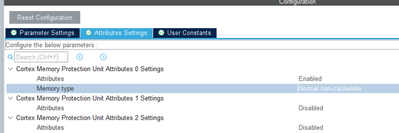

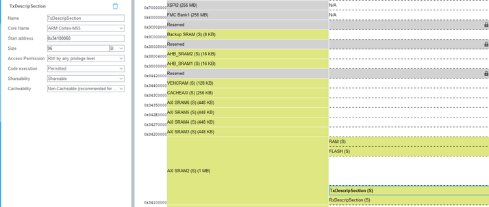

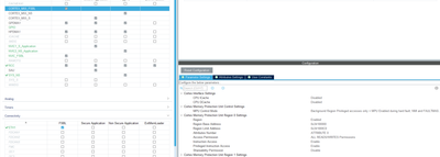

Among various attempts, I was also trying to use the Memory Management Tool to move the RAM and FLASH regions in order to assign explicitly regions for the Ethernet descriptors. However, The Tool does not let me move these regions (my project is in XiP mode, if it matters).
I have then some questions about these two related issues:
A) Ethernet and NetX Duo Initialization
1. Am I missing some software initialization step, or misconfiguring the hardware in some way? I went through many examples and I do not find an answer, also given that the configuration sometimes differ among them.
B) Memory Management Tool (XiP Mode)
2. Assuming explicit descriptor placement is necessary for a fix, what is the procedure to unlock, and modify the default memory regions within the STM32CubeMX Memory Management Tool, so that I can define custom memory segments?
Any guidance on resolving the MAC silence or navigating the memory configuration tool would be highly appreciated. Thank you. I attach a .zip file with all the code and the .ioc file.

Hello @ACR,
Unfortunately I am not going any further in solving this issue. I saw your post before, and also some other related to a similar problem, but i still cannot find a solution.
However, I see from your post that you can assign the ethernet descriptors region in the Memory Management Tool. For me I was not able to assign them becasue i was not able to move the ram and the flash regions (and the descriptors must be placed in the address space occupied by the ram region). Did you find a workaround for this or am I just doing something wrong (I know that i need to activate the flag in Code Generation Configuration, but I am not able to move the regions anyway)? This would be of some help for me, thanks
Best regards
ACR
Associate II
Hello @damole ,
By using the MMT I could generate a new linker script, with defined Section for both descriptors.
I am not sure about what the MMT does, I mean there are several options (cacheability, shareability,...) like below:
It seems that these have no effects, I couldn't find any changes in the generated code. There is also the MPU, where you can find this parameters.
But implementing this didn't resolve my problem.
I don't get this point, but I saw something like that in the NX TCP ECHO Client example, where the descriptors were defined in the RAM defined memory. I didn't try.
Best regards,

I am now able to send raw ethernet packet (didn't try reception for the moment). The solution is to enable RIF in STM32CubeMX, for the FSBL in my case.
Best regards,
damole
Associate III
Hello @ACR,
Thanks for the hint. Could you explain better what do you mean by enabling the RIF? I see a lot of configurations available, I am not sure I understand what do you mean.
Best regards
