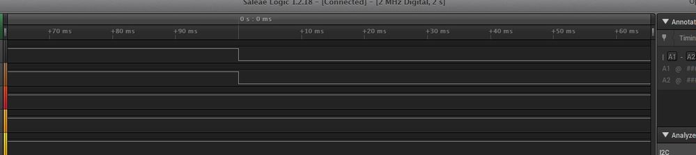

Method 1 :
HAL_I2C_Master_Transmit_DMA(&hi2c1, 0x4E, &Data_M[0], 4);
Nothing come out at the logic analyser

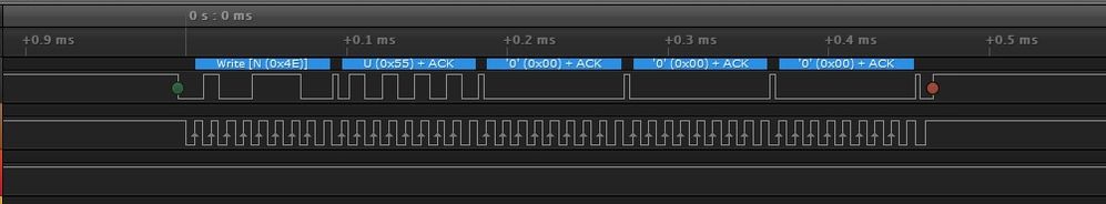

Method 2 :
HAL_I2C_Master_Transmit(&hi2c1, 0x4E, &Data_M[0], 4,1000);
Data come out just nice
