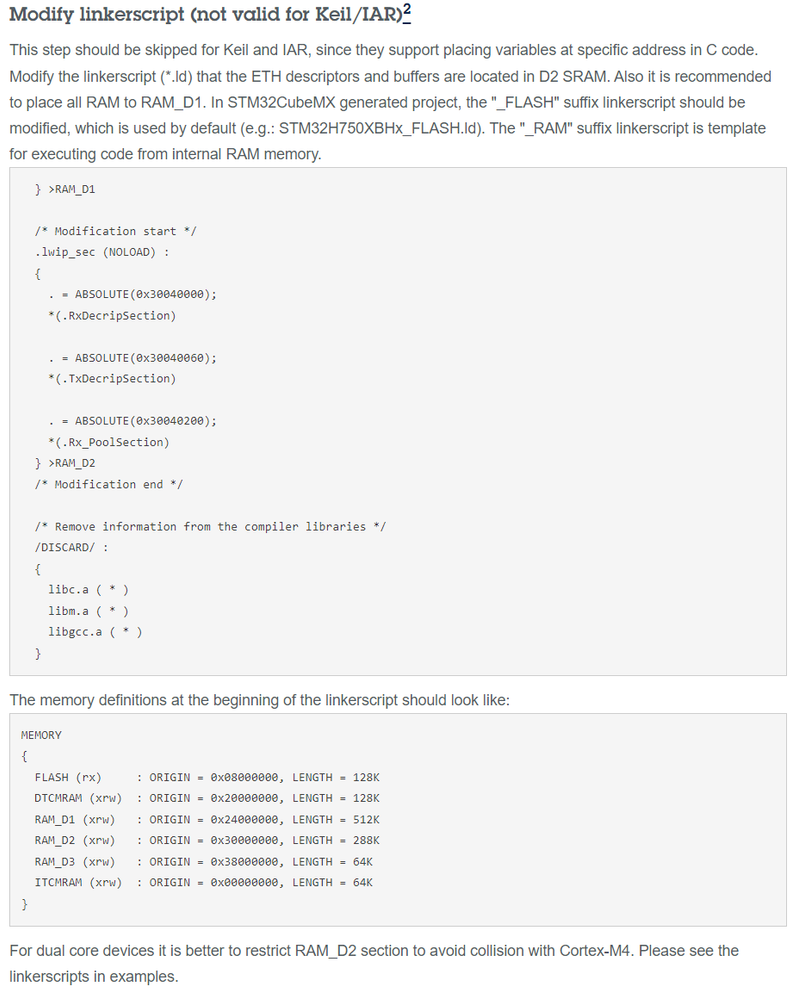

the fact that this should be placed in the Flash.ld file is mentioned in this article How to create project for STM32H7 with Ethernet an... - STMicroelectronics Community which can help you to achieve your goal of developing TCP and UDP server and client.
here is the section mentioning this
