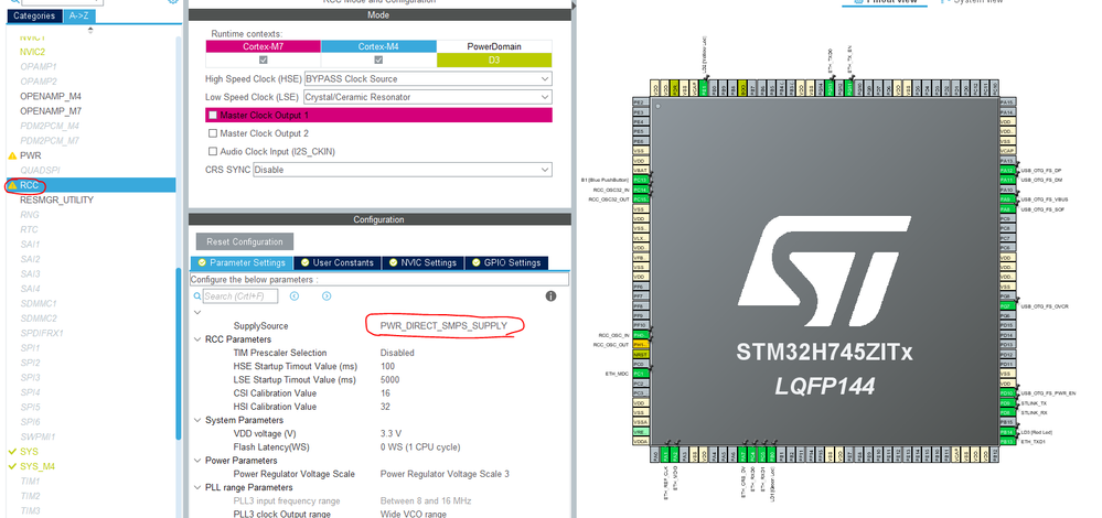

As the Support of ST pointed out, it can be found at the RCC -> Paramater-Setting -> SupplySource (Parameter) .
Many tanks to the ST Support. :thumbs_up:
