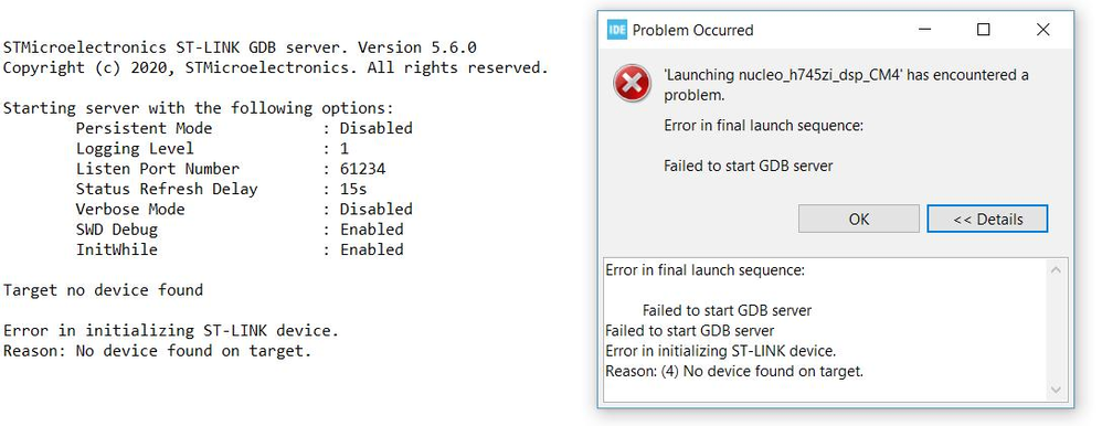

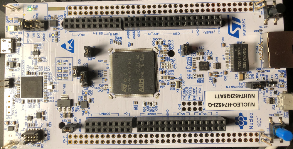

after programming the code via the OnBoard ST-Link and connecting/disconencting USB on the Device side in order to find out if the works, I can no longer access the microcontroller.
I have no idea what the rootcause is, 3.3V is fine. Could it be that the MCU is stuck in a lowpower mode(I did not configure any).
Thanks a lot.

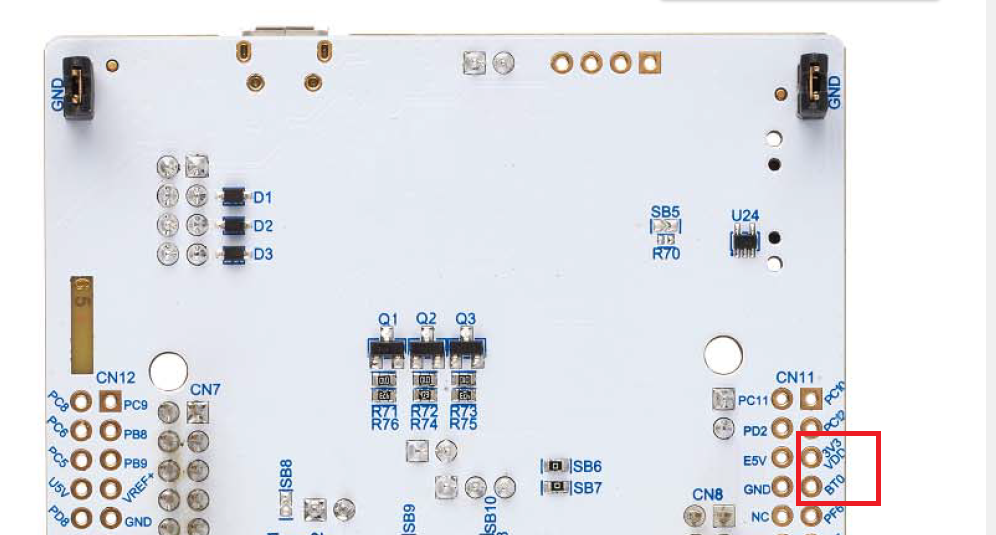

BOOT0 is a pin controlling boot behaviour into ROM or your code into FLASH.
Should be marked on one of the pin headers, and findable via the User Manual / Schematic, usually close to a VDD pin for easy connection
Ok, I found it:
  1. Disconnected the USB ( Debugger)
  2. Jumperwire from 3.3V to BT0
  3. Connected the USB (Debugger)
  4. Started the Debugging in the STMCubeIDE
  5. Party :grinning_face: !!!

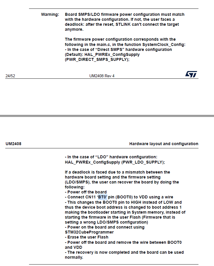

There is a seperate section in the Manual, I added it so others that read this post can find it instantly:

Board provides for multiple powering methods, SW and HW need to be consistent.
Looking at this blindly, I'd guess you selected the LDO, not the SMPS setting
 HAL_PWREx_ConfigSupply(PWR_LDO_SUPPLY); // USED THIS, FROM H743
 HAL_PWREx_ConfigSupply(PWR_DIRECT_SMPS_SUPPLY); // WANTED THIS

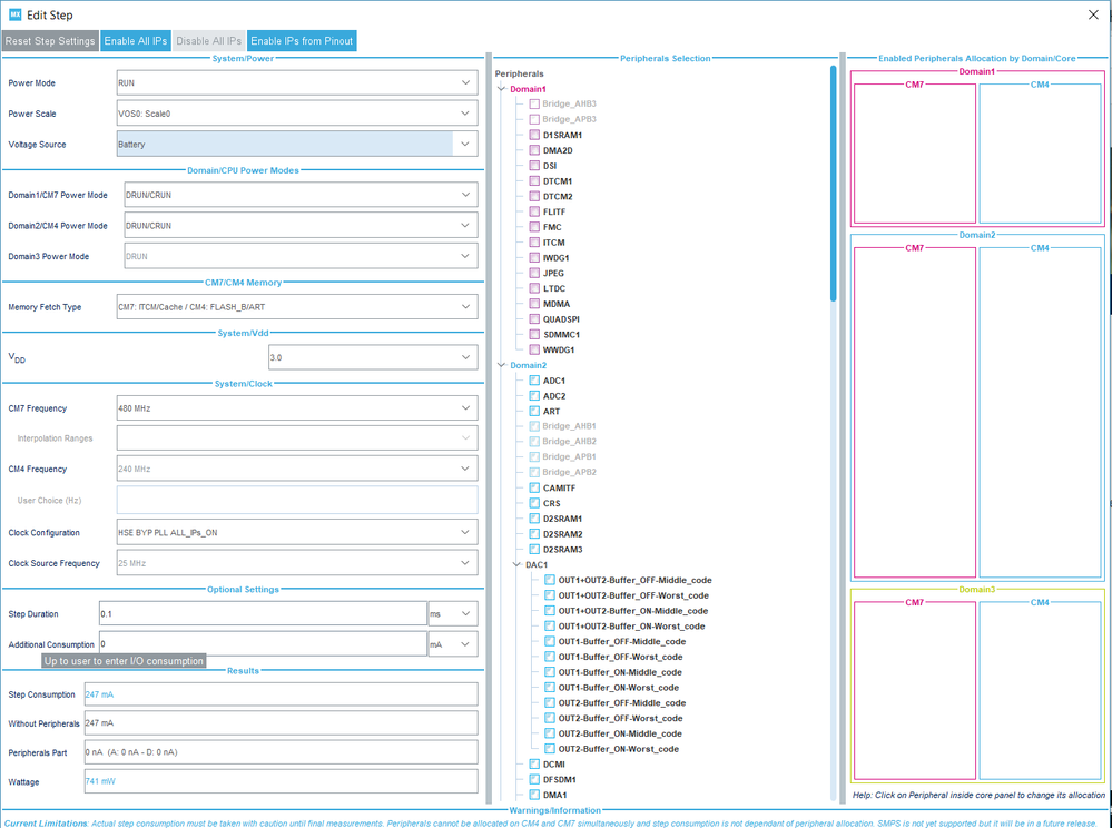

Wow, I can't even find these settings. the settings should be in the config-Tool?
All I found was this:
I'm not a CubeMX/IDE/WTF adherent, I work code the old fashion way..
