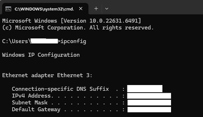

Hello @mpek29, and Welcome to ST Community!
To run the example in the hotspot, you first need to configure the STM32 to be on the same network as your computer. To do this, follow these steps:

@STackPointer64 wrote:
- In your STM32 project, open the lwip.c file and set the same Default Gateway and Subnet Mask, but use a different IPv4 address by changing the last number.
And ensure that last number to be unique in the network: not used by another device on the network.
