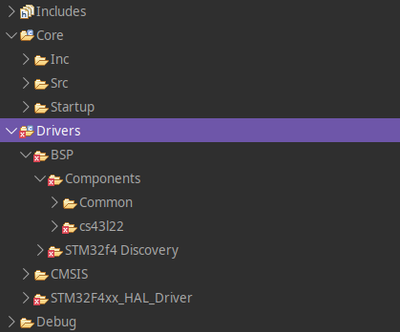

I’m not too proud to use official drivers, though, and, with your encouragement, though, I tried again. I tried two methods. The first method was to follow that github link and add related directories from github according to what was mentioned in the readme files and what was demanded when I tried to build the project. This is the file structure I wound up with:
With the ‘Drivers’ directory filled in like this, I was getting the following build error, at the peak of a tall pile of build errors:

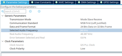

The driver instructions don't mention that some configuration is needed in CubeMX, although the I2S2_init function unhelpfully says, "This function assumes that the I2S input clock (through PLL_R in Devices RevA/Z and throughd edicated PLLI2S_R in Devices RevB/Y) is already configured and ready to be used."
I copied the settings seen in this instructional video. That didn't work, but it did at least cause the callback functions to start being called... once each, then never again, with the hi2s2 state staying as HAL_I2S_STATE_READY.
I2S2 settings:

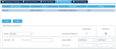

2025-01-08 7:23 PM
I've learned that the I2S handle created by CubeMX doesn't actually do anything on its own. In fact, the f407-DISC audio driver makes its own I2S handles. I was incorrectly using the CubeMX-generated handle to monitor the state of the I2S connection. When I instead monitor the hAudioInI2s handle from the audio driver, I see that the state sits at HAL_I2S_STATE_BUSY_RX, while hAudioInI2s.hdmarx->State is stable as HAL_DMA_STATE_BUSY. I think that this is what it aught to be in a properly-functioning setup, but the problem remains: although the DMA callbacks appear to be firing correctly, the data appearing in my audio buffer looks like random noise.

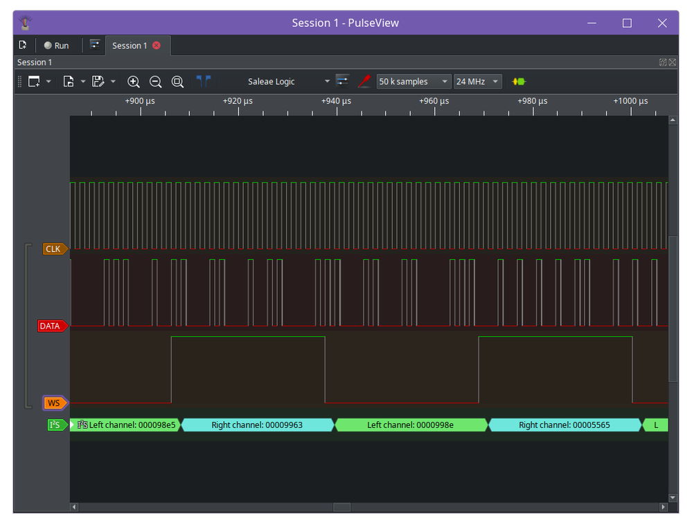

I got a cheap logic analyzer and looked at what was going on:
Could this be anything but hardware damage? There is near silence in the room, so the MEMS microphone should be transmitting zeros as its PDM signal, right? If so, this is the second board which I've seen behave this way. Is there some novice mistake I'm making which could be damaging them?
