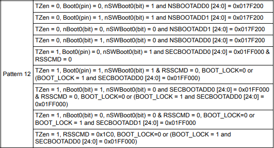

I have code that's meant to put an STM32L552xx microcontroller into bootloader mode after reset, so I can connect it to CubeProgrammer afterwards. I tested the code and while it does appear to be doing something, it isn't showing up in the device manager in any sort of update mode, nor can CubeProgrammer find it under the USB tab.
I'm still looking into causes, but I wanted to check to make sure that this wasn't a simple case of me misunderstanding the instructions from AN2606, table 2 (I'm using Bootloader Pattern 12, trustzone disabled and boot0 pin pulled low).

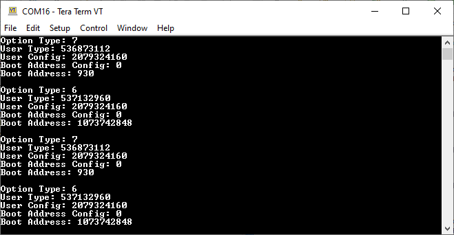

Alright, still not working, but I collected some more information from some debug code.

}This is what's being output on Tera Term. The above screenshot is from two consecutive runs of prepareForUpdate().

2022-11-01 11:57 AM
You maybe dont read precise, before get config is
/* Prevent Access to option bytes sector */
HAL_FLASH_OB_Lock();
/* Disable the Flash option control register access (recommended to protect
the option Bytes against possible unwanted operations) */
HAL_FLASH_Lock();
/* Get FLASH_WRP_SECTORS write protection status */
HAL_FLASHEx_OBGetConfig(&OBInit);and maybe order is too critical. First OB then flash ... and real programmin is started with Launch , not with OBProg...

2022-11-02 7:00 AM
I actually did mess around with that yesterday after I had a little mixup. Almost bricked the USB C side of my NUCLEO board, but was able to fix it with CubeProgrammer.
As for unlocking Flash and OB Flash, it has to be done in the order of Flash, then OB Flash, otherwise it hardfaults. I tested that already.
Circling back to the "almost ruining the USB C" on the NUCLEO board, I realized that when I ran HAL_FLASHEx_OBProgram(), it was only programming the user type and user config option bits, not the boot address or boot config address bits. I split ob_cfg into two (one for user options and one for boot options) then ran HAL_FLASHEx_OBProgram() for both of them, leading to my PC no longer being able to connect to USB C. Additionally, it still wasn't detectable as DFU, though I will note that I currently have USB C configured as a VCP, and not as a composite VCP and DFU device. My research suggested it was unnecessary to do so, but I'm beginning to reconsider.
Edit/Update: I got something! When I went into CubeProgrammer, I changed NSBOOTADD0's value to 0x17f200. The way I had coded it in the version that broke the USB C's connectivity changed NSBOOTADD0's address to 0x17f200. The address should be 0x0bf90000.
That said, you are right; it appears to be locked in bootloader mode until I turn off the option bits. Still, this is good progress I feel
