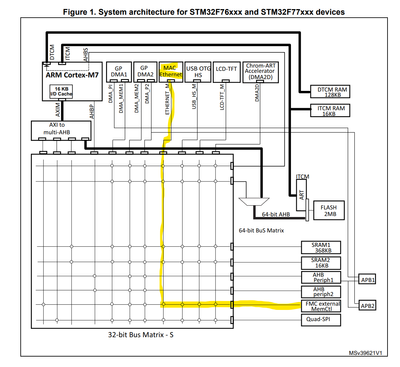

Regarding "I have an external SDRAM (FMC interface) currently being used for a display buffer with plenty of space available is it possible to configure it to use as the buffer?"
if you meant using the SDRAM via FMC interface for DMA buffers and descriptors yes this could be done
