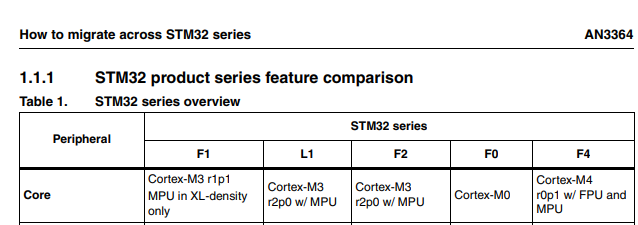

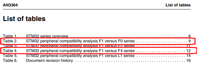

Doesn't combining Tables 2 & 4 give you F4 vs F0:
See also Table 1;
Going from F4 to F0 is a "downgrade"

"Doesn't combining Tables 2 & 4 give you F4 vs F0:"
Sort of... :smiling_face_with_smiling_eyes:
Taking the ADCs as an example:
F1 vs F0
F1 vs F4
This tells me that the ADC is different to the F1 on both the F0 and F4. But it doesn't tell me if the F0 and F4 are the same (I suspect not).

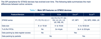

Another example, I know the SPI on the F0 and F4 are different, as the F0 uses version 1.3 of the SPI peripheral, rather than the 1.2 version in F1 and F4 (as described in AN5543).
This is covered in the tables, and can be understood, but only because the F1 and F4 are fully software compatible (hence I assume they operate the same, but are de-featured at the lower IC):
