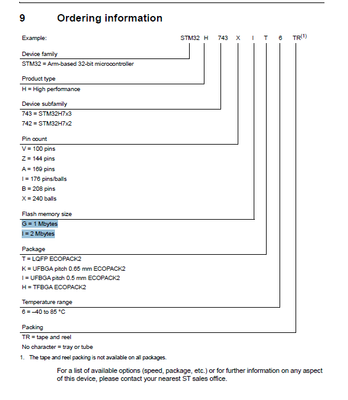

2025-03-28 4:07 AM - edited 2025-05-29 8:52 AM
STM32h743VG6 (I assume you mean STM32h743VGT6).
The only difference I can see between STM32h743VGT6 and STM32h743VIT6 is the Flash size:
In the case of 1MB of flash, the Flash is not seen as a single block of 2MB (contiguous flash block) but two separated block of 512kB of flash. So you need to check that point.
