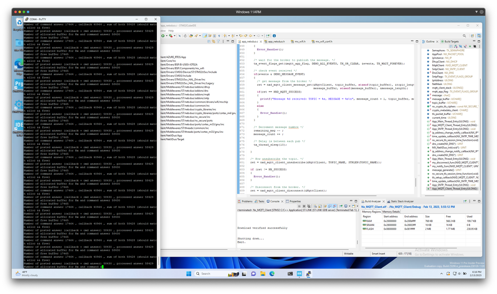

I loaded a fresh Windows 11 with the latest STM32CubeIDE and imported the current Nx_MQTT_Client example. Changes as detailed above (plus WIFI_SSID and SSID_PASSWORD in mx_wifi_conf.h). Downloaded the compiled image to STM32U5 p/n 497-B-U585I-IOT02A-ND. It ran really well until it got to around 9000 messages and then ***BOOM***.
That 9000 messages is not cast in concrete, it really can crash earlier or later.
Please let me know if I can help with more info or tests.
Thanks again for your help - I'm dependent on this board being stable using RTOS/WiFi/MQTT/Encryption.
