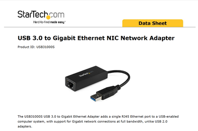

2025-05-16 4:14 AM
I try to make a universal USB to Ethernet adaptor. So every device can be plugged and work without use an RNDIS driver. Like one you can buy online (example startech).
