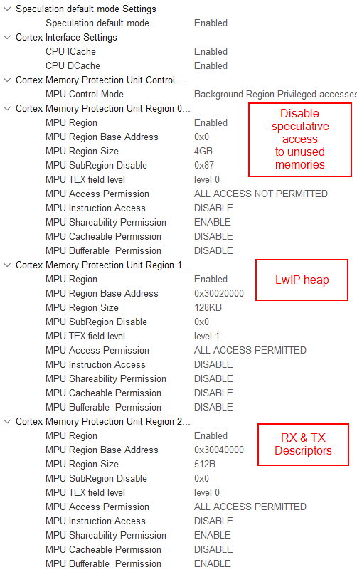

Caching significantly improves lwIP stack efficiency by reducing the time needed for data access. Turning off the icache can cause latency since the processor has to obtain instructions from the main memory, which is slower compared to the speed of accessing the cached instructions.
Regarding your cache issue, please verify the MPU configuration against the picture below:
