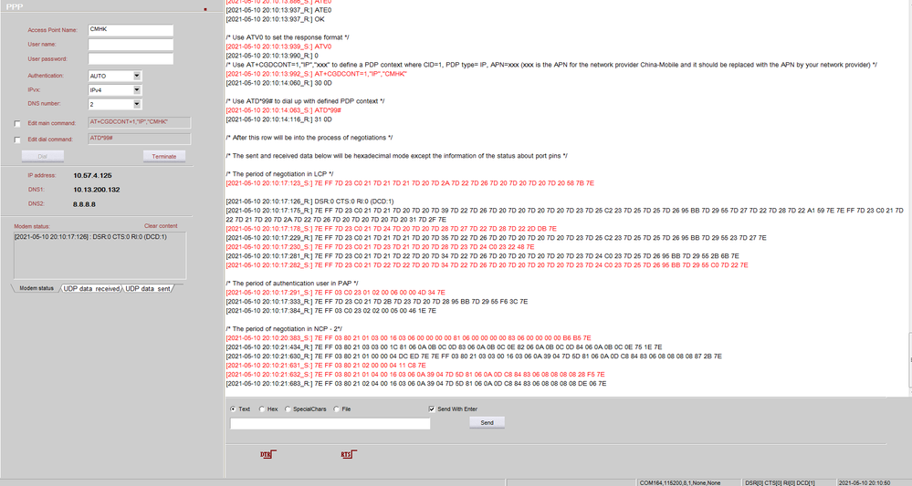

Thanks for your reply. I attached the log with USE_SOCKETS_MODEM. The APN should be right (no user name and password) and we have checked it with the service provider. Here is a screenshot of QNavigator for your reference.
I also tried to use PAP by uncommenting this code but still not work. Perhaps I need to show the verbose debug log of LwIP but it takes me some time to use LwIP's debug feature with the trace component in X-CUBE-CELLULAR.
ppp_set_auth(ppp_pcb_client, PPPAUTHTYPE_PAP, "", "");
I will try with another antenna and see if the result is different. Thanks for your time.

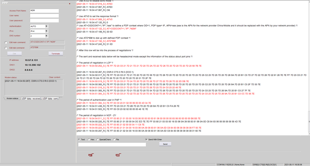

I see that when you use QNAVIGATOR, the context is CMHK (AT+CGDCONT), but when you use X-CUBE-CELLULAR, I see that context is M2M (AT+CGDCONT), so I suspicious that the PDP context activation is rejected by the network.
As you use the X-CUBE-CELLULAR 5.2.0 for your project, you can change the APN using the setup menu (option 1: setup configuration menu. In this menu, you can change the APN to CMHK, once modified, you can store the configuration in the flash memory and restart the device.
Then please double check that before AT*99#, the correct APN is configured.
