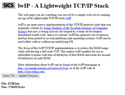

Hello there, I'm writing a STM32 update firmware function (using lwIP ) that accepts a HTTP Post Request to send a new .bin file.
After selecting a .bin file to transfer from the PC to the MCU. I use the following line to capture the request:

You can see Content-Length is 176815 while buflen gets a value of 614.
I have some questions and would appreciate any suggestions from you:
1. Please help me point out any mistakes, if there are any.
2. Why is there a difference between Content-Length and buflen?
3. How can I receive the content of a .bin file to store it in flash? Any examples or suggestions would be greatly appreciated. Many thanks.
