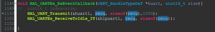

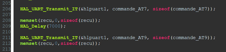

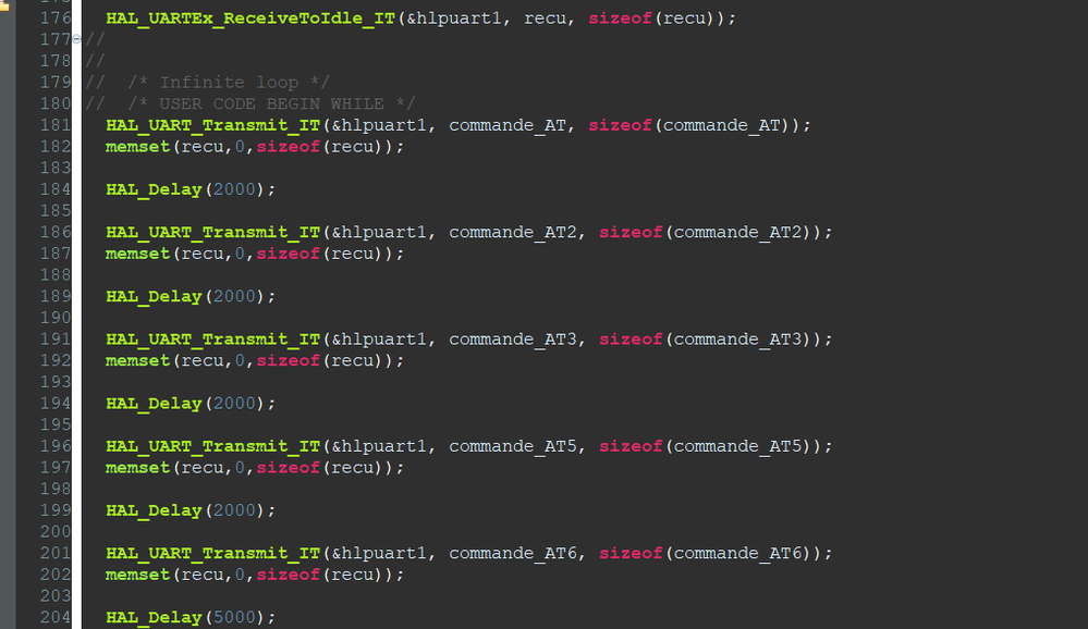

Finally the interesting parts of my code :
Commands and reception buffers:
I presume there's a problem in receiving and displaying the data received. I know my "received" buffer doesn't contain many characters at the moment, but I should still be able to receive the start of the page, shouldn't I?
Does anyone know what the problem might be?

Don't use blocking functions (HAL_UART_Transmit) inside of an interrupt callback. Any characters caught during this time will lead to an overflow error condition. Perhaps set a flag and handle the transmission back in the main thread.
Monitor for errors by implementing HAL_UART_ErrorCallback or examining the software state machine (hlpuart1).
Don't mess with writing recu in the main thread--it may be being written in the interrupt. If you want to zero-initialize it, do so right before HAL_UARTEx_ReceiveToIdle_IT.

With AT commands it's generally better to process the responses in a stateful manner, looking for OK, ERROR, NO CARRIER, etc rather than blind / arbitrary delays.

I used HAL_UART_Transmit_IT and it's working fine!
Thank you!
