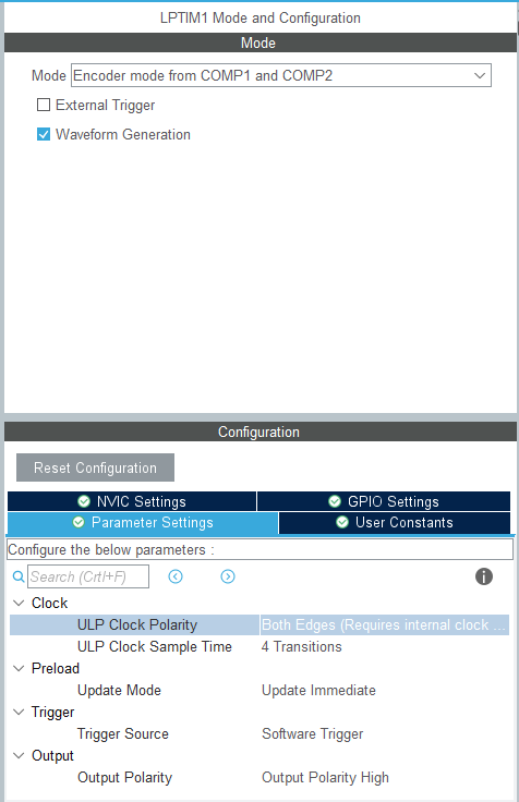

I am currently working on a project using a sensor that sends quadrature encoded data. I have it wired so that the data is connected to comp1 and comp2 which in turn is read by the LPTIM1. LPTIM1 is set to encoder mode, but for some reason I for the life of me can't figure out why it won't count. If I use HAL drives instead everything works fine as I would expect. HAL_LPTIM_Encoder_Start_IT() is the function that seems to make all the difference and I cannot replicate what its doing with the LL drivers.
Mx Setup
Below is the working code for HAL drivers with what the registers look like for comparison.

The interesting thing is, I was able to get it to count in LL if using only Rising edge or only Falling edge but it was very inaccurate.

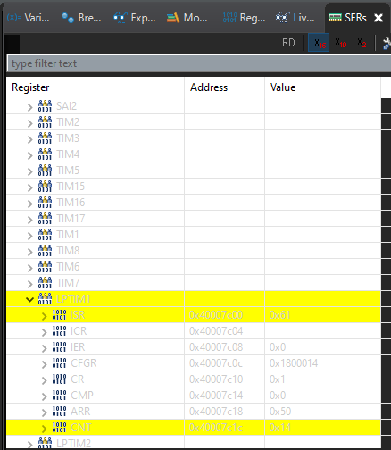

2021-10-21 12:39 AM
Read out LPTIM and relevant GPIO registers content and compare to working case.
2021-10-21 10:16 AM
Yea that was one of the things I attempted to no avail. As far as I could tell the gpios, comps, and the LPTIM registers all looked the same. This is what lead me to believe that it might have to deal with the order in which setup/initialization was done in. Although, that doesn't really explain why on LL I can get the counter to work when I only do rising or falling edge but not both for clock polarity.
