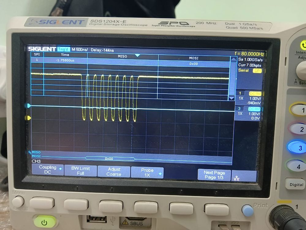

Initially, I just wanted to check if the SPI is working, so I used an oscilloscope. I did get a signal, but it looks different than expected. I sent a single data byte, 0xFE, but the oscilloscope on the MOSI pin shows 0x00
here are my connection IOC Connection
Clk = 64 MHZ
mode :Half Duplex Master
Data Size :8 bits
baud rate : 4MBit/S
CPOL : HIGH
CPHASE : 2 EDGE
Connect the probe to MOSI. Currently it looks like it's connected to SCK.
My STM32 stuff on github - compact USB device stack and more: https://github.com/gbm-ii/gbmUSBdevice
no dude! i connected everything correctly
I verified hardware connection, as per our connection set up,
Controller - SPI2 CLK is connected to CRO channel1 SCK
Controller - SPI2 MOSI is connected to CRO channel3 MOSI
Controller - SPI2 CS is connected to CRO channel4 CS
Anyone please help me!! i am waiting for your response
