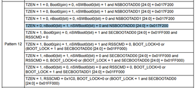

As a boot patter i've selected the highlighted pattern in the screenshot below:

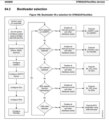

2024-09-01 10:54 PM
AN2606 talk about jimp to built-in boot loader or system boot loader. Are you trying to jump to the system boot loader and trying to communicate over that to program the device or have your own boot loader?
the best way to check if the processor jumps to system boot loader is to use the STM32Cube programmer.

2024-09-02 10:46 AM
Okay so it's confirmed the jump into bootloader isn't happening, once SysMemBootJump() is initiated the mcu restarts.
2024-09-02 11:12 AM
In your code i see more missunderstanding... When you read and use Pattern xx no jumping is required, but reset MCU. Too in both method reset or jump no UART config help. System code do itself inits and work only on pins listed in AN2606, not any pins you setup...
As first step connect STLINK and setup manualy OB as you plan test. After validate OB setup simply reset or power off on and System loader is started.
