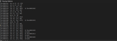

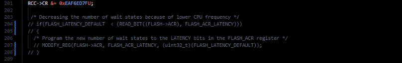

I am facing issue as i am trying to jump from bootloader to the Application code which is located in the SDRAM. In the bootloader stage when the MCU receives the binary from OTA it is stored inside the External Flash. After receiving the binary image and storing it inside the External Flash, the image is copied from External Flash inside the SDRAM and then jumps to the application code. When it jumps to the application code, i open disassembly view and it starts running instructions stored inside the SDRAM until it reaches a specific address `0xC000150E` which is inside the `SystemInit` function. After calling the instruction at this address the disassembly closes up and a text of can not read register at `0xDEADBEE` appears.
When checking the line located at this address and commenting that line which is this
the problem persists at the same address of `0xC000150E` even though the previous line was commented out. It always crashes at this address. Kindly someone suggest what could be the issue? Why it always crash at this exact address.
Here is the disassembly before and after commenting that line
