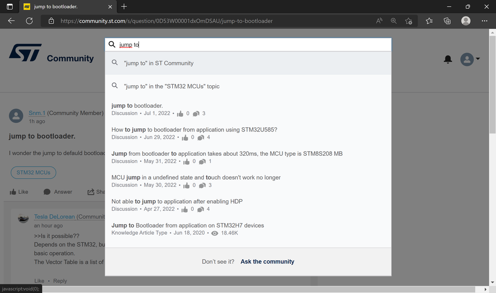

2022-07-01 3:48 AM
Try search first ...
2022-07-01 4:10 AM
I didn't found, therefore i ask.
