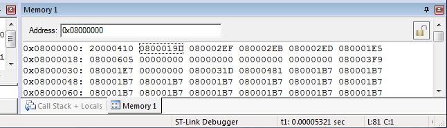

Look, you're not trying to jump to 0x08000004 but the content pointed TOO by it, indirectly.
You also don't want to be jumping to the main() function because it would ignore all the C runtime startup code which copies your statics, and clears your initial variables. Observe the ODD address of the code that is supposed to get jumped too.2014-04-04 4:45 AM

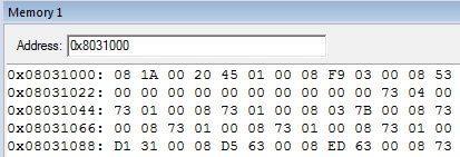

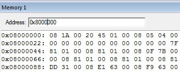

this function is now working, but i'm reseting in loop. And when i'm pointing to the second binary at 0x8031000, with the same software than binary1 I have the same address pointing to 0x800001452014-04-04 6:37 AM
Hi
''And when i'm pointing to the second binary at 0x8031000, with the same software than binary1 I have the same address pointing to 0x80000145'' The second version of the application need to be located differently.2014-04-04 6:49 AM
