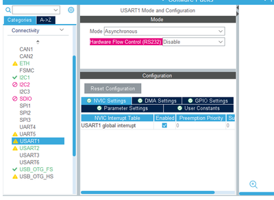

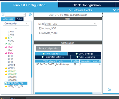

Hello @Saket_Om,
Yes, I have enabled global interrupts in .ioc configuration settings, I am receiving data from Ethernet to UART & USB, please find the screen shots for your reference.
